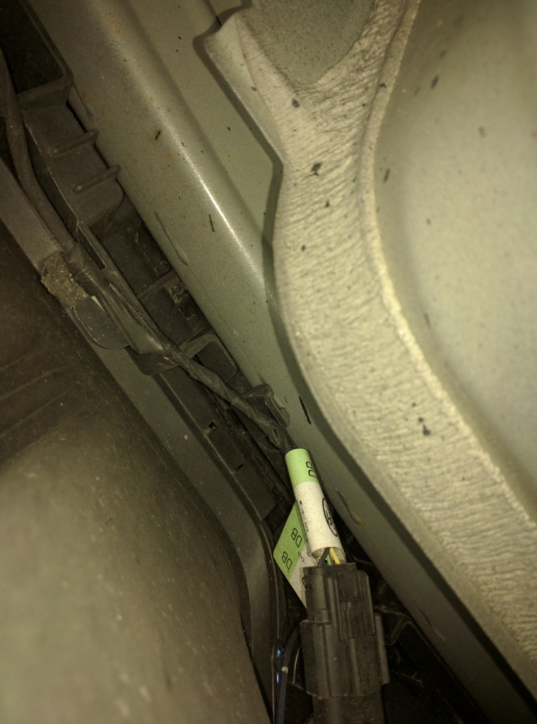

As I told you. I think every Mustang 6 is rusty at this part.

It is not as severe as on your car, but it will be over time. See pic. To see the rust spots you may need to enlarge it.
Typically that only these fenders have this problem. The rost is also coming in middle of a surface not only on joints. I will ask for replacement of the fenders. Covering them with wax will not solve this.- Auf_Wunsch_gelöscht6

This picture is from the back fender seen from belowMonkalamar hat geschrieben:Which fenders? Front or back?

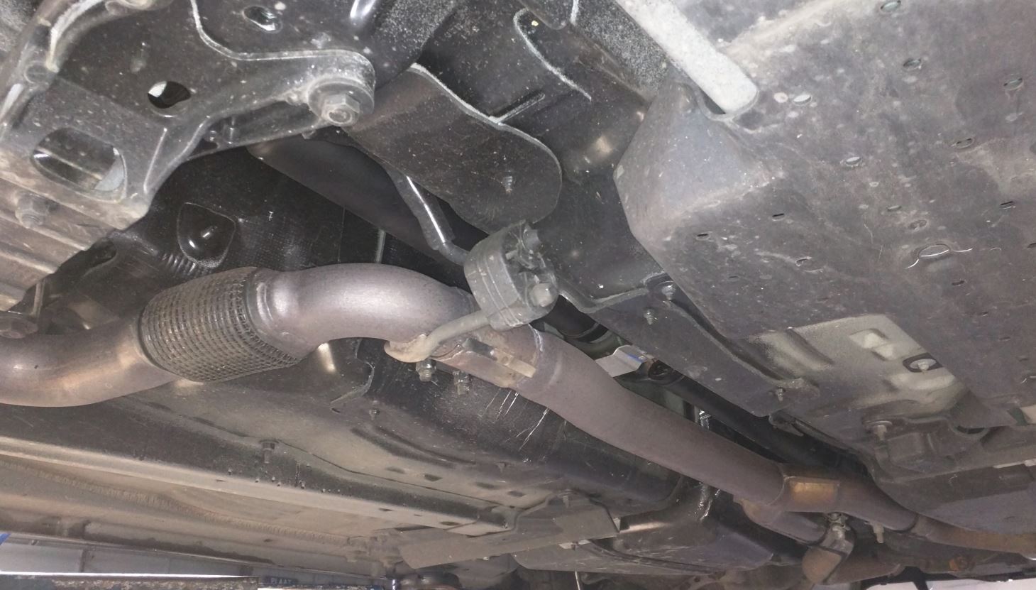

new pictures, car now 2 years old standard ford UBS, no visible rust..
